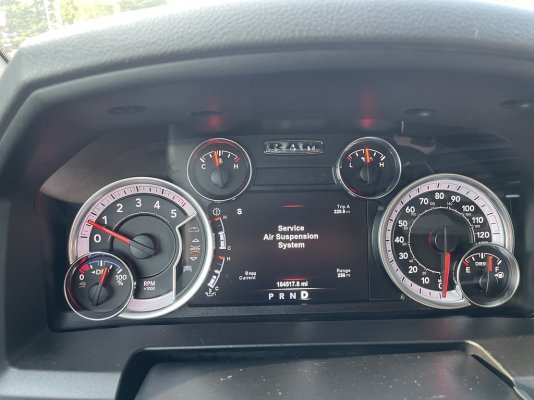

My '17 Dually will intermittently throw a service air suspension warning in the EVIC complete with the dang ding. It only stays on for a few seconds. Driving me nuts. Might go hundreds of miles and never happen then will go off 10 times in 10 miles. Been to the dealer a couple of times. No codes and of course never does it when it's there. I'm guessing it's a partially broken wire in the wiring harness but see no damage to the harness and the shake test comes up empty. Had a similar issue with my Laramie Sport 1500. It was tripping an ABS code. Literally took 6 or 7 trips to the dealer over many months to finally find the broken wire. Anyone had any such issue or any ideas for the dually?

Finally got the thing to do it while I was close to the dealer. Dropped it off without shutting it off for them to scan it. And it needs a compressor. :rolleyes:

Had this problem with my 2019 3500. The intermittent service alarm eventually stayed on. Found the compressor motor had gone out so replaced the entire assembly. Worked great for about a year. Now I'm getting the intermittent alarm again. This time raise & lower work fine, just have the annoying intermittent alarm. More so going down hill or braking than while accelerating. Any ideas?
