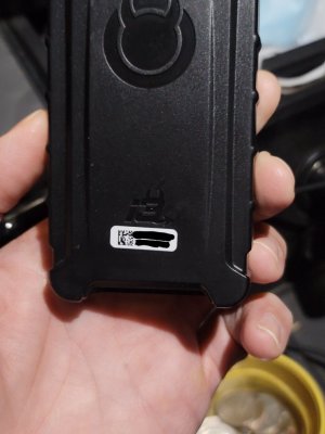

I can't tell if you're trolling or just unaware but that serial number is on the back of your i3 tuner. There is a little QR code followed by the codes.
Nothing against Moe's but if you called me asking the same questions I would stop answering you also probably after the first time. ;)
For i2 try this
Settings> tool info> tool status.
Good luck:cheers:

You have the i3, i have the i2. No number on the body of the tuner. Perhaps they saw the error of not having it easily attainable and made that correction with the i3?
Still nothing from diablo sport
Moes referred me to them for any help as the i2 is no longer made.
Second picture is the i2.
