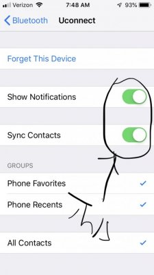

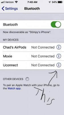

This is more then likely the problem.... 99% of the time. Mine didn't work until I did this.
Most likely in the UConnect setting on your phone. Go to settings, then bluetooth, then click on the "i" next to uconnect and make sure "show notifications" is turned on. This resets everytime to pair your phone.
Thank you!! I will pass on the info to her. [emoji16]
