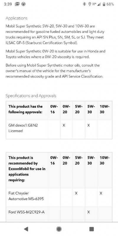

unfortunately , rumour has it, our 3.6L ram is factory filled with pennzoil garbage..... can't wait to do my first change.... I have 4 new left over 5L jugs of mobil 1 from when I had my F150
Mobil 1 does not have the Chrysler certification.
