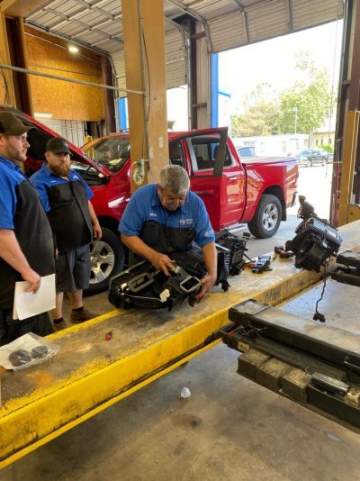

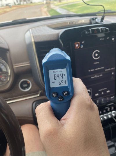

I also have a 2019 Longhorn. I'm located in TX and it has been 100 deg plus more days than we care to talk about. 58K miles and have been researching this same issue. Just today I took mine into the dealership for another issue but took the TSB paperwork with me and ask for a estimate on the cost to perform it. Approximately $1500. He said they have done a few but honestly didn't see that much improvement like others have said in this forum.
Here is mine take on it. I've always felt my biggest issue was air flow. It's really poor. One post on here mentioned they changed out the cabin air filter with a K&N washable cabin air filter it made a significant difference in my truck. Another tip I got here is to keep the air on recirculate. These 2 things changed the performance to the point where I am no longer considering the $1500 dealer option. I'm going to try this for awhile and if it isn't enough my next step is the valve shutting off the water flow to the heater core.

I had the TSB done while under warranty, and it dropped my vent temps from 50's to 46 ish. But, if you have done, beware, have a good dealership, MX, because they Pull the Whole Dash and all HVAC system. If they are in a hurry or not a decent shop, who knows how they will put it all back together. To me, there is nothing worse than driving down the road and a squeaky dash. I still have my clamp in the truck, and if the temps get too hot, will clamp down the water pump outlet hose, and you can get temps down to like 38 more or less. See pic, all dash parts pulled and HVAC, etc.,. Luckily, my SA had the most senior tech working on my truck and he did a decent job.
