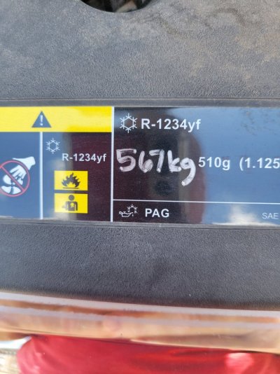

Here's my experience. Bought my 2019 in Jan.2019. When it warmed up, off to the dealer I went with poor cooling AC. Dealer said that the wrong tag put under hood that shows ac charge, charged the system and it cooled better but not great. Lowest vent temps I ever get is 50 deg regardless of out side temps. All vents show about the same. The new freon R1234yf, is junk in my simple mind. Dealer also said they found 4 more 2019's on lot with the wrong tag. I think 2019 was the 1st year they used that freon. Noticed some reported temps in the 30's, maybe they improved the system. Pic of tag below shows what they changed the charge to.
R1234yf goes back years. My '18 uses it, and apparently Dodge started the switch over as early as 2014.

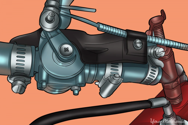

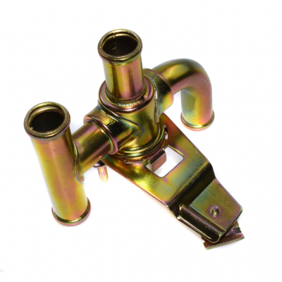

do you recall when almost every vehicle had this set up
It went in the water supply line that passes through the firewall & goes to the HVAC unit
I always thought about a slightly different valve
This type would allow normal flow into the heater, but you could change the flow to bypass the heater & return the flow back to the return line to the radiator.
Just a thought that i keep having

I tried two versions of the pneumatic one in my last truck and they both leaked. I ended up with a ball valve in the supply line as my final solution for that truck (Ford F-250).
Although that worked great I wasn't interested in having to go under the hood to make temp changes for this truck. I'm glad I pushed for the TSB until it was done. The results were night and day.
