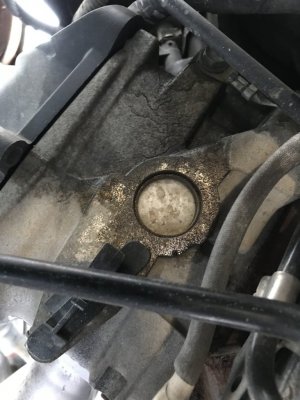

6BDA2DF6-921D-456D-A0CC-ECAF3455AFF5.jpeg So I have posted this pic for the leak that you can clearly see. Mechanic here in no mans land says it isn’t leaking. I beg to diff! It’s not oil as I assume it was a valve cover, was not. Hardly no smell and it appears almost like a water substance. Anyways, if you look closely at the top of the freeze plug (drivers side rear pic from underneath) it looks like the engine is cracked right by the bolt holding what appears to be a ground? Is this just a surface crack and what is this bolt holding to the engine? My truck has been to stalling or just not start after driving fine. I have to get a boost and she starts right up and won’t give me a hard time starting for awhile and then does it. Could this wire be the cause? Ground?
Thanks for any insight.

View attachment 211226 So I have posted this pic for the leak that you can clearly see. Mechanic here in no mans land says it isn’t leaking. I beg to diff! It’s not oil as I assume it was a valve cover, was not. Hardly no smell and it appears almost like a water substance. Anyways, if you look closely at the top of the freeze plug (drivers side rear pic from underneath) it looks like the engine is cracked right by the bolt holding what appears to be a ground? Is this just a surface crack and what is this bolt holding to the engine? My truck has been to stalling or just not start after driving fine. I have to get a boost and she starts right up and won’t give me a hard time starting for awhile and then does it. Could this wire be the cause? Ground?
I’m not sure, if it’s possible to put your hands there, does it wiggle? by wiggle, does the metal it’s screwed into wiggle? I don’t exactly know, but it looks like dirt that had some sort of water run through it in a very fine bead and it made that effect. I’m not so sure though.

Looks like an engine ground strap to me. If you can, remove it & clean both strap & block. As for the cracks, I'd wire brush the surface for a better look.
Looks like one on the right side of the freeze plug too.
Could just be paint scaling.

Same here, I don't see that those are cracks. As far as the leak, maybe a little coolant sneaking past the freeze plug?
It’s above the freeze plug and coming down past it. My first thought was intake manifold, but according to local mechanic from Sesame Street, it’s not the intake manifold.

Looks like yoru freeze plug is weeping and needs replaced.
Regarding your Battery issue, strongly suspect that is exactly what it is, a battery issue.
Think about it, once that bolt was attaching that wire to teh block and seated, how in the world is it gong to lose connection for electrical current to pass through it?
Only possible way is if the wire attached to the connecting piece which the bolt pases trhough is corroded. Which I doubt, oooks liek far too much oil and gunk on it to be corrdoed.
far more lieky your actual battery is weak. No matter how strong the battery or how stron the Jumping battery, if there is no solid ground, it ain;t gonna work. which really makes me think its the battery.

The spiderweb lookin part above the freeze plug is is from the block mfg process. It looks more like its raised than a cracked area. The wire is definitely a ground wire. And may trace it back to the battery. While tra can it check the wire for cracks and corrosion too.

I don't see actual cracks - looks like casting flaws, probably harmless. As to the truck stalling then running fine for a while - there may very well be an electrical connection issue - plug on the alternator, battery cable, even a defective alternator - way too many things to even ponder here - but I would begin with every electrical connection related to the alternator, battery, and fuse box.
