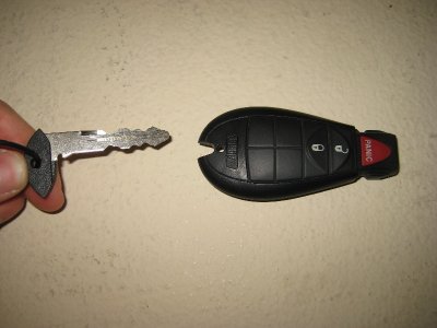

Don't you have a key in your remote?

I do, but that key doesn't do me any good if the whole FOB is locked inside.
Ah. Been there, done that. I always work out of town so I just keep a spare key for the truck and my camper in my pocket. I leave the 2nd FOB in my center console just in case something happens to my main one. Easy for the truck to get stolen, but if I'm 8 hours from the house I can't exactly have my wife run me the extra key.
