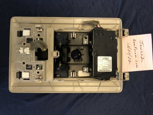

I know. My question is whether the current console I have has the blockoff panel I would need to put in another one if I took out the rear window switch. Or is there a separate version of the panel that has homelink and NOT the rear window switch. I can't find even a photo of one with Homelink and NOT the power window switch.
I just sold one, here are a couple pics
