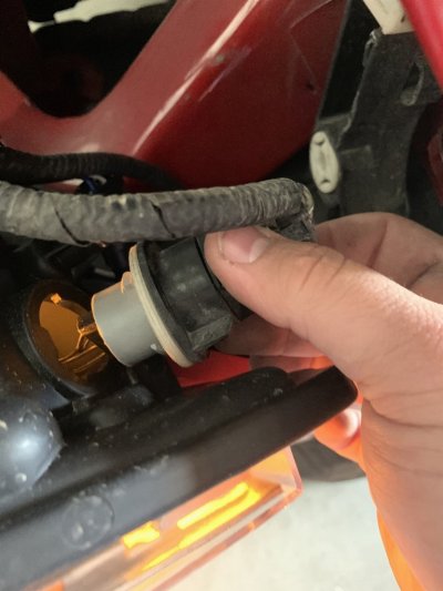

Looking for some assistance. I bought the modifystreet projector headlights for my truck and they are so nice. But when I was going to install them I noticed that the connector for the blinker on my truck didn't match the one on the headlights. Unsure of what to do and would like some guidance. Thanks

You have to reuse your blinker housing, take out the bulb, and push the new connector into the old blinker housing. If that makes sense for you. Maybe post a picture of what you’re looking at? I can get a better idea of what you mean.

Take connector out if stock, plug the blade connector from new into it, twist whole enchilada back into new housing.

I just had to take my right headlight out due to the blinker not wanting to work. Well I pulled it into the garage to work in it and it started working again... didn’t touch it... figured I’d take it out and reset the connection. Works fine now. But here are some pictures of what you’re looking for. eb0870b0f8f4dbe33d6ba724991f7507.jpgc60a39e2e05371eca2ee687f31dc14aa.jpge5b925159d16548cdb99570b5901cf30.jpg
