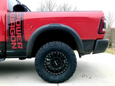

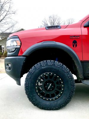

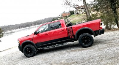

03923137-6D74-43BC-899E-7D064939ACB1.jpeg F2AC4C59-0F60-4A83-A848-C55C16163670.jpeg 05022C06-9607-4207-82B3-971B52E61623.jpeg 18C4CADA-BD8F-4420-8E2D-4C1389A8707B.jpeg I gotta say, today was a good day. I got my Method NV 18x9 +18 and Milestar Patagonia MT 35x12.5. I used the Tazer Ram to calibrate the odometer. I assume entering the new tire size also adjusts shift points? The speedometer seems to match what is on my Waze app, so that looks good to go. If I understand right the new tpms will auto sinc in 40ish miles.
I really haven’t noticed much if any feeling of lost power, and I was driving very conservatively, but the mpg didn’t really seem any different.
As far as noise level this is my first set of Mud tires (besides stock) so haven’t experienced loud tires, but the stock duratracs seemed completely silent, where the Patagonias are louder. Not bad, but I can hear them. That was one of the main things YouTube reviewers would say is that they are the quietest mud tires they’ve ever heard (so far nope). They do look freaking awesome though!
