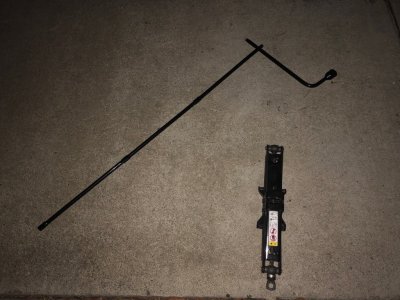

Am driving a 2014 dodge ram sport 1500.
I was just going through my jack kit and noticed the last connector rod (3rd piece) is missing. I only have 2 pieces. Where can i get the last piece of the connecting rod in Calgary? Any ideas?

Are you sure? i did youtube videos and they have a total of 3 pieces to be connected , so it wont scratch the bumper.

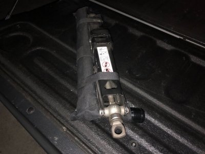

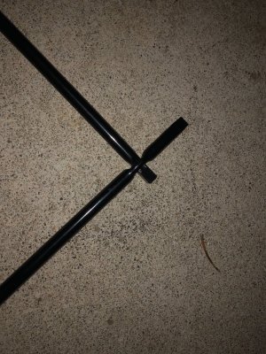

NOPE. Some people just think that because the end of the hook tool goes into the end of one of the square tube connectors for storage. Same way most people say their tire/wheel winch is broken or frozen because they assume you use the narrow end of the square tube connector to attach to the square on the winch when it's actually the big square end that goes into the winch*. OIW: O/P is correct, there is a square tube connector missing and it is needed. See pics, hopefully this helps out if the question of what's included or how it all packs back up ever arises. :D *Because the narrow end fits into the square flat of the hook tool so you can screw and unscrew the winch. ;)
Assembled for tire/wheel removal.
Factory kit in-full.
How everything stores in the tote bag.
How the hook tool attaches.
Properly stored and secured to the jack to be put back under the passenger seat.

Make sure if you get a replacement piece you remove the silver button clip from inside the small end of the square tube connector. Only 2 of the 3 should have them, the third generally does not. Or else it sticks in the hook tool flat and is a PITA to remove.

Thanks ORT. Last night i tried to connect the first 2 pieces and try to lower my spare tire and it works fine. But since is short, is scratching the bumper which no one wants. Also i thought the third piece does not have the silver button clip (is not a connector) and thats how it comes and we dont need to remove that silver button clip.
