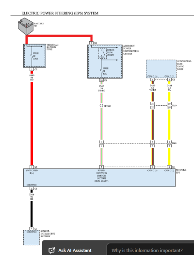

This is from the factory service manual for my 2013.
According to this, fuse 78 comes from the ASD relay and is only powered when the truck is switched on.
Fuse 2, 100a should be powered all the time. If fuse2 is good but you still don't have power at the module, then you probably need to inspect that power cable, because it doesn't appear to have any more connector between the fuse and the module.

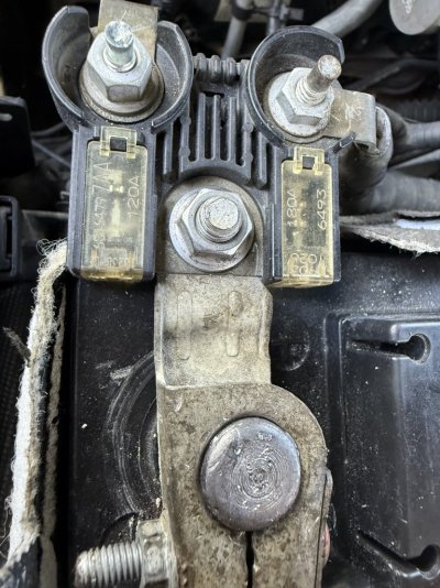

Thanks for this. I’m looking and I can’t seem to spot 100a fuse? Mine at the terminal say 120a and 180a. Both have power after the fuse

It should be the 120a
disconnect it from the battery and the steering rack and check continuity with your multimeter, but the 120a should be it.

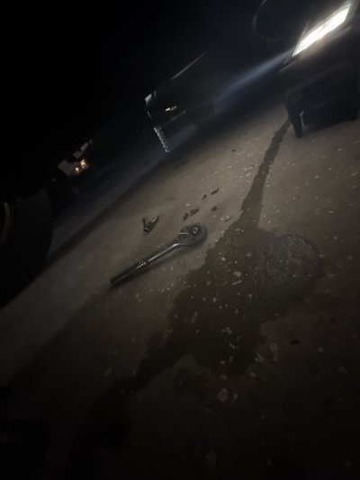

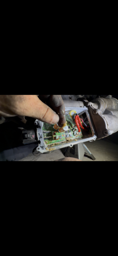

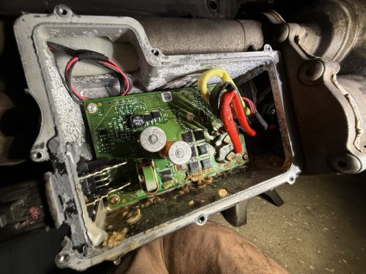

So about the time you posted that reply I had just found and ordered that exact security torx set on Amazon. It came and got a minute to try to pop the panel to circuit board open. Super awesome that it POURED water out when I finally broke it free… sucks, but also my biggest fear was popping $2k for a new rack and it actually be in software or other electronics and it not solve the problem. Now I pretty much know it was the circuit board.
For others going down this road in the future, one hint I had before this, I went to start taking out the bolts to that circuit board cover and I accidentally nicked the 4wd and the panel at the same time as the bolts for eps module and there were small sparks… interesting. Put my multimeter on and I had continuity between eps module and frame. Hmm Then, I unplugged the big plug to module and it went away. Back in and it was back. So obviously electrical shorting out somewhere (inside the module full of water)
Right now, I have the rack fully off the truck and sprayed the **** out of the board with isopropyl alcohol and letting it air out overnight/next day. Throw it back in and see if I have any luck. Worst case is it’s fried and I have to get another one. Honestly not too bad to pull out, 4-5 bolts and you can drop it.
Wish I was smart enough to attach the videos, but the photos of puddle and gunk inside housing get the point across I think.

Yea about 2 days before it started acting up we had a huge downpour here in Florida. Happens all the time so didn’t think much of it. The road from my house into downtown was flowing water above the curb all the way across the road. I could feel the resistance from the water as I drove. Didn’t seem deep enough to get up that high though, but even then, I’ve had truck in water that deep before.
Must have found its way in I guess though.
Yea I’m confident in the replacement since I’ve now had the rack all the way off, inspected and dried module, replaced panel and mounted it back on the truck. Unfortunately still didn’t work, but I didn’t have high hopes it would.
