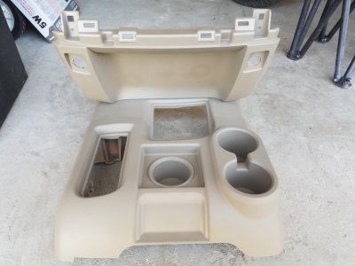

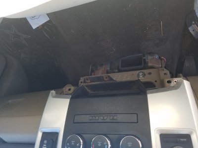

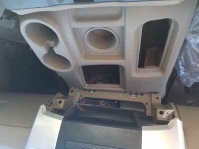

Hey all, I've done a little digging, and I've seen a few people swap their jump seats to consoles, I'm going the other way however. As of right now, I have the seat and seat belt in, so it funational, but I'm having a hard time finding the rest of the pieces I need to close in the dash. I had the Dodge house help order a couple of the pieces (pictured) but I'm still missing some obviously. Has anyone else done this swap or know what else I need to get for a clean, psuedo-factory look? Thank yall in advance!

Sorry for the pics being upside down, not sure what happened there...

I have the dash bezel if you still need it. I'll swap you for yours even up

you need the dash bezel for a truck without the center console and to make some sort of filler panel or bin for the 4x4 shifter cut out.

So, just the dash bezel? I figured it was something like that, just wanted to be sure before I order a bunch of parts I don't need
