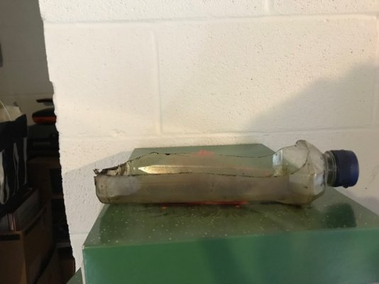

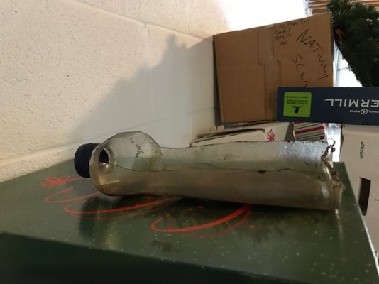

To keep the oil filter from dripping all over creation while unscrewing- I simply cut out a 1 1/2" drip pan from a plastic bottle (the thicker the plastic better for stability)- cut it long ways- then slide your new drip pan up and under the oil filter- viola! Works like a charm, however you do need to carefully slide it out after the oil stops dripping, otherwise the pan will tilt and you still get soaked! Took me a couple of oil changes to get the hang of it, but didn't spill a drop last month for my 3rd oil change. I considered the PAC oil relocation, but this (much) cheaper yet (just as) effective method does the trick for me and keeps my arms and basement floor oil free.
