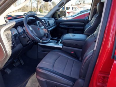

Changing the stock foam and covers on your existing seats is the "cheaper" option. Still fairly costly though, expect to spend at least $500 for the upholstery/covers, and the underlying foam. Removing the old leather and foam pieces is pretty difficult and time consuming. The easier option is find another 06-08 truck at, say, a scrapyard, and remove the seats yourself. Seats are a direct replacement for all 3rd gens. Be mindful of features your truck is equipped with, such as seat heaters or power seat operation. You must find seats that also have whatever options your truck has if you want everything to work right with no custom wiring. Finding a set of nice condition seats is pretty hard at pull apart yards. Seat tears/rips/foam sagginess is common for the seats of all 3rd gens, not to mention whatever nice condition seats they had are most likely gone now. Buying front AND rear seats that are in nice shape off eBay is gonna run you about $2,000.

Swap in 4th gen stuff. I managed a factory replacement black carpet for mine (it was originally black, I just needed to replace it). OEM ones are a bit difficult to find but they're out there.
