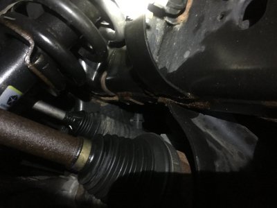

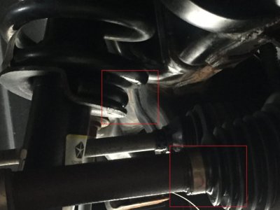

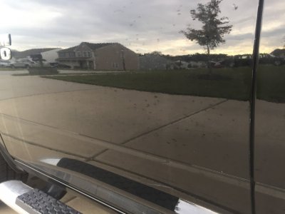

Hi Gentlemen,
Ive been lurking around here for a while. I was able to secure a truck over the weekend. Which I am so pumped up about. I flew up to Toledo,OH to buy it, and drove it back to the Charlotte area yesterday. However, I noticed there was some fluid on the driver side of the truck this morning. Under further investigation it seems like it is coming from a boot (possibly) inside of the front driver's side wheel.
Considering I just dumped a "truck load" of money (to me) to get this truck, I wanted to see if any of you could help me identify the issue so I can try to cut cost.
Below are the pictures I took form where I believe the leak is coming from.
Any and all help is very much appreciated!
Specs: 2013 Ram 1500 4X4 Crew Cab Sport 5.7 Hemi
Mileage: 78,000
Pics: Front Driver Side Wheel Well.
-Crispy

It 'might ' be a loose clamp on the CV boot ..
Wash it off good and keep an eye on it.

Clean the truck up, really good. I'm betting you ran through some oil on the road during your trip home. That's the only way I'm seeing it thrown up the door that way.
emjohn4
Jul 25, 2012
1,220
868
The stuff on the door is likely tire dressing that has 'flung' off the wheel during driving. This happens to me if I put it on too thick.
However, the leak / wetness is likely not the CV joint...but from above it. Above it is the power steering tank, and further back, the brake booster & master cylinder. Either of those, if leaking, would drip and land on the areas you indicate.

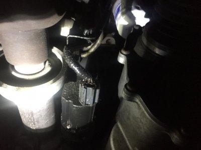

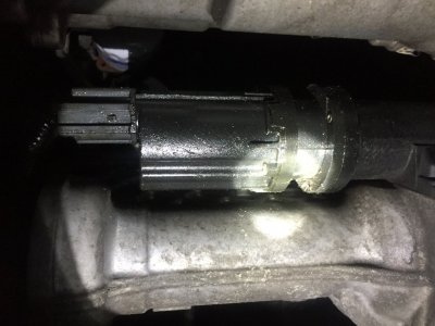

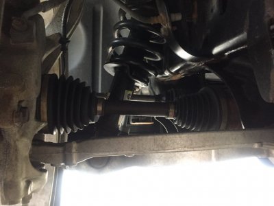

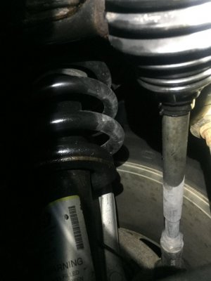

I tried to snap some pics with a flashlight. I found another area under the center front of the truck as well. Not sure what the black plastic piece is, but possibly tied to power steering. Some of the pictures really show the level of fluid that has been thrown around the under carriage. Hate to sound dumb, but if any of you can see anything please point it out! I know the photos really aren't that great.
I'll try to take some more tomorrow, or if nothing else, provide an update.
Thanks for all the help, guys!

I'm at a loss. Check out the rack and pinion and see if it's leaking out the drivers side into the boot then leaking from there.
Hopefully it's not brake fluid leaking all over your painted surfaces.

Do as "gofishn" suggested above, in order to see the leak, you need to go through a touch-less car wash with an under body blaster. Clean up as much as you can at home with rags, then at the car wash, spray some de-greaser on all the grime, let it sit for a few min, then go through the wash. Then after a day of driving you should see if anything is seeping out. I have a feeling that most of the grime seen in your second set of pics is from a previous oil change, the oil filter will drip all over the area that you have in the pics including that front axle disconnect module you show in a couple of the pics.
