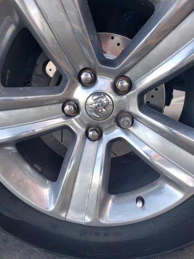

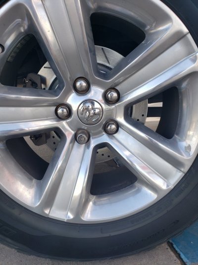

Again get what you can affordable. I went with the Z36. Install wasn't too bad once the rear rotors were off. That parking brake is what got me.20200229_171821.jpg20200229_171830.jpg
