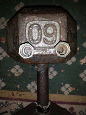

Here are a couple that I had laying in my tool box. The one on the right has the regular size hole it comes with. That one needs to be stuffed with steel wool. The one on the left has been drilled out to fit the sensor. Stuff the one on the right with 0000, then screw the one on the left into it. Screw both into the **** and finally install sensor.

ok, the one on the bottom has the threads cut off, it tapered down before the threads so i drilled the hole in the pipe that size then sat it in the hole and welded it in, then drilled the second one out so the sensor would fit then screwed them together.

That's where the problem is. You will need another non fouler to make that work. Take out the sensor and the one the sensor screw's into. Get a new one, pack it with steel wool and thread into the ****. Then thread the outermost non fouler back into the packed non fowler followed by the sensor. Make sure you pack the steel wool tight. That should eliminate the code.

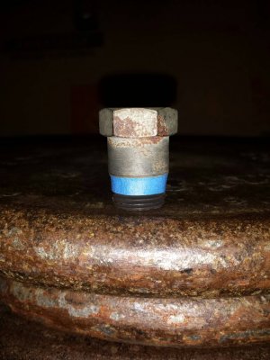

I measured it out, as long as you didn't cut the non fouler you are using as a **** above the top of this blue tape line you are fine packing it with steel wool.

i cut it right where the threads started. and its not open all the way, just a small hole maybe a little bigger than a pencil.
Blackram
Apr 18, 2013
393
82
Then your are good. Stuff it with 0000 then put the other non fouler and sensor back in. Pack the steel wool tight.
