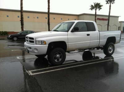

Here are before and after pics. Leveling kit was done today.
Eventually I'll get larger tires, but for now this will do.

Looks good man. What kit did you end up going with?

The place that I took my truck to used Pro Comp leveling kit and new shocks as well. After driving up my mile long rocky dirt road to get to my house, I definitely have to say the ride was a lot smoother than with the stock shocks that were on there.

Looks great! Look into a DT Protofab adjustable front track bar. They are adjustable, so you can re-center your axle after the leveling kit, and eliminate the stupid factory ball joint design. Might as well order up the gear box brace at the same time. You'll be GLAD you did. Made a night and day difference in my '00 Ram. Can't believe I drove without it!

Thanks for the advice! I will eventually. My truck is a slow work in progress fixing it up because of lack of money haha :)
