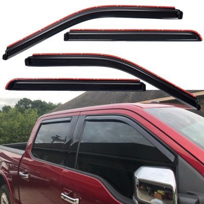

It is caused by wind and air pressure. Does it happen with both windows down. Does it happen if you roll the windows down all the way. Usually it is worse with rear windows down, not so noticeable on the fronts. Has never had anything to do with the noise cancellation. The Plastic window rain guards will often reduce this effect.
