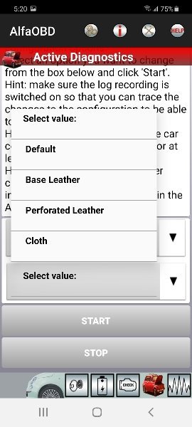

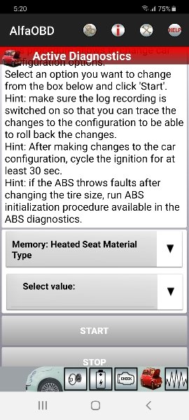

You can adjust the heating temp on your factory seats with the Alfa tool. There are three settings, cloth, perforated leather and just leather. Not sure if you have the Alfa or not but thought I would mention it. It's in the Memory section under (seat material type). I haven't seen anyone comment on whether or not it makes a big difference or not. When I upgraded to Laramie heated/vented seats from standard manual non heated seats and I enabled all the heated/vented seat codes I set mine to (perforated leather). They seem to work pretty well. I have been considering changing to setting to strait leather to see if they actually get hotter. Of course this will only work if you have the factory setup. ee6b15272e639b79034b2c994ebcee9e.jpgefef6e749456ae34737033ddbca68ba8.jpg
Sent from my SM-G981U1 using Tapatalk
I'll try it tom and get back to you! Thanks sir happy holidays!
That’s awesome ! Can u tell me how to get to that menu? I have alfaobd
Just go into the Body Computer and scroll down to the (Car Configuration Change Menu) and select it. Then scroll down to the memory section and then select (seat material type).

Update! I used the advice to change the memory seat material to leather instead of cloth and sure enough.... it worked! My seats become noticeably warmer compared to the cloth setting . Thanks again to those who helped!

Did you do base leather or perforated leather? Or does it not really matter which leather you pick.
BEAST19
Mar 26, 2017
1,067
742
I chose base leather as my katskins aren’t perforated. Also I assumed... using logic.. that it would allow for a higher temp threshold than perforated would due to the thicker material. [emoji2373] could be wrong tho
