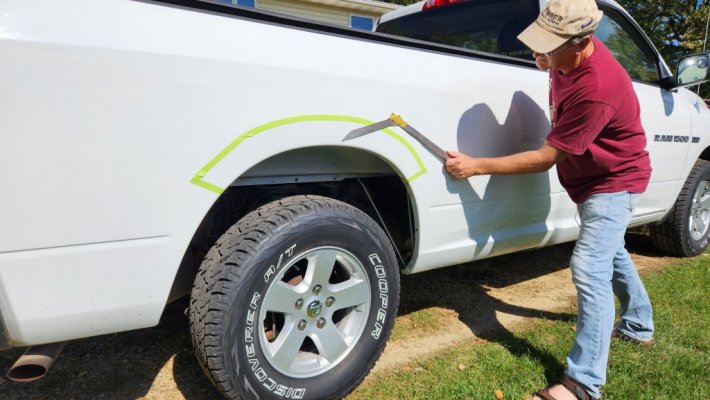

You could do the rockers, and that might buy you a couple more years. And maybe you should do that. Bodywork and refinishing wouldn't be that expensive. The problem is you live in the NE ....the cab corners and box wheel wells are right behind the rockers. My neighbor's Ram was just like that (rusted wheel wells).
You 'could' clean the rear wheel wells and put a bunch of oil up there. I say oil ...because you want it to 'soak in' real well. The tailgate too.
Scroll down about 1/2 way on this pg. I wrote up how I cleaned out my tk's wheel wells. You got to get all the rocks, sand, leaves and crap from around the wheel wells. Maybe if you do that, it'll buy you more time to keep what you have looking good.

Note: A lot of guys are going to tell you to use Fluid Film or another spray rust coating (e.g. Rust Stopper). Those work great on flat bare steel and other brand new panels. But around real wheel wells start with a product which will soak wherever it can. Seep in ..through the tiniest of holes or crevices. And then apply a 2nd application after a month or so. And if you can work some between the metal layers (horizontal side) of the wheel lip, even better. Ram used a seam sealer at the base of the wheel lip between the outer and inner panel. Fluid film doesn't seep in cracks/crevices the way oil will. After the oil has mostly seeped in and dripped out, then you can follow up with a Fluid Film or Rust Stopper (same thing, different mfgr).
I sprayed Fluid Film and Rust Stopper on horizontal rusty metal surfaces. After a couple weeks they didn't seep down that much. A little but not that much. Oil seeps down and around right away. Start with the oil and follow up with the other stuff if you want. Just sayin'...
If you want to keep your Ram looking good, definitely get on the rear wheel openings ASAP. It's a lot of work but it'll help stop the rust in it's tracks. As much as possible. You can't really *effectively* repair rusted wheel wells (coming from yrs of body experience) once you have rust-through.

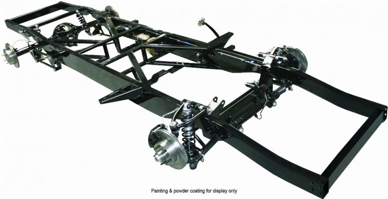

If i am going to spend $80,000 on a new vehicle, it will be because of necessity.
I am going to drive my 2016 eco-diesel, until it begins to cost me enough money, that it starts to irritate me
At that point, i will buy a new truck or build a truck, basically from scratch
this frame brand for illustration only
the cab will be similar to this
i was building a similar truck before & it was drivable & street legal
I much rather drive this, than any new vehicle made today
