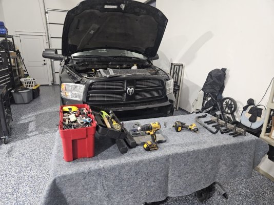

He's gonna crack open the valve cover and see if he can replace valve spring or see if it is a valve spring, first time for him. Have any advice rick? I said to run engine when cover is off and check it that way, and to do all 4 while it's open. My guess is valve spring, I forget why I believe that after talking with him for a while my guess is that. Anything he can do before poping cover?

I think you covered it Mike. I forget who i suggested it might be a spring,but either way,he should pull the valve cover on that side.

Here's some pictures so far. I've got just about everything out of the way enough to get the driver's side valve cover off. So far this thing is much easier than my 3.3 Stinger was at getting to certain areas of the engine. Coils are out, harness to all coils and injectors, alternator etc, are unplugged and clips unplugged to move the harness out of the way.

Couple more

With that writing on the valve cover,do you know if it's already had an engine swap.That writing looks alot like what a wrecking yard might write on a valve cover
I've no clue at all. I guess it wouldn't really surprise me. Starting to regret this truck purchase. That makes me nervous.

The seller only owned the truck from 144k miles to 165k miles and I know I couldn't find any history on the vehicle. All the seller had done on the truck is plugs, belt, and oil changes in that time of ownership. If it was replaced, I imagine it was a long time ago as in more than 5 years ago.
