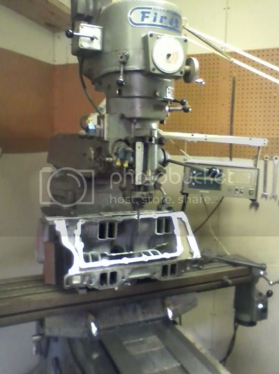

Started on my keggar mod today :birgits_tiredcoffee
From starting with this....
To this :roflsquared:

No cut-off wheels and die grinders for me haha

nice man. wish i had access to a machine like that.

Thats in my fathers shop, along with a lathe and other equipment

Yeah, my father is a retired Tool N Die Machinist that has a lot of his own manual equipment for doing side jobs. In which I get to use at my leisure if they are not in use hehe

Was your plenum in need of repair or did you pull your intake just to mod your keg? Im on the fence about the hughes air gap but there are so many mixed reports, i hate to spend $600 and then be like wtf? Some say its a kick in the ass and others say its no big deal. For $600 i want a big deal. Please let me know your thoughts on the mod after you get behind the wheel.

$600 for what? Yes I needed to do my plenum fix cause the gasket is blown out. I actually picked up a used intake off craiglist for $35 and am modd'ing it while I still drive my truck that way its less time my truck is down.
