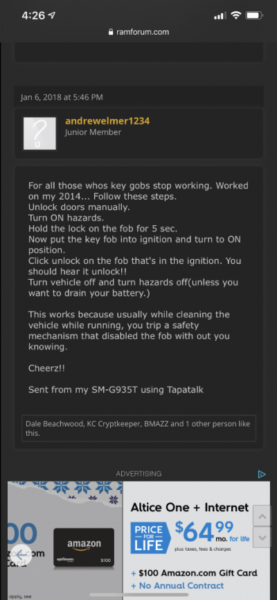

One of my fobs stopped working. First I Cleaned the fob out (multiple vids on you tube) and changed the battery. Still didn’t work.
Then did this and it worked:
Thank you I will try that. Cleaned out all internals. Lock/ unlock works perfect now. Turns on rarely but at least the truck recognizes the key again. Didn’t have a problem again after doing that?

Nope. Works great now.
