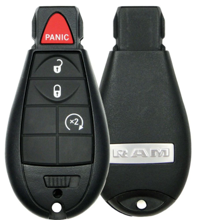

On this video, a bit different key. I have the same key fob like model since 2013.

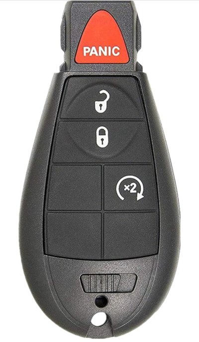

You can have remote start without having an RF hub. The WIN module controls the remote start. In the first picture below it shows the remote start connection on a 2011 WIN module. It’s the pink connector. In the second picture below is what your key probably looks like. This type key was used with WIN modules and RF hubs.
RF hubs weren’t used till the 2013 model. Also you stated you programmed a new key. Did you use Alfa OBD to program it? If you have an RF hub you need an electronic interface to talk to the RF hub, it’s a much more detailed procedure with an RF hub versus a WIN module. Does your remote start work from your key fob? If it doesn’t I’m guessing your WIN module is bad.
The ignition switch behind the dash is much smaller on 2013 and newer vehicles because they have a RF hub. If you pull the lower dash panel and you have a rather large black plastic box for the ignition switch you have a WIN module as it handles the signal functions from the key fobs. It could also be a wiring issue in the TIPM but likely the WIN module.

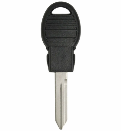

There are 2 types of key to start the ignition
This is called a Transponder Key, it has a CHIP inside of it
then there are different FOBs
same except for the number of buttons
