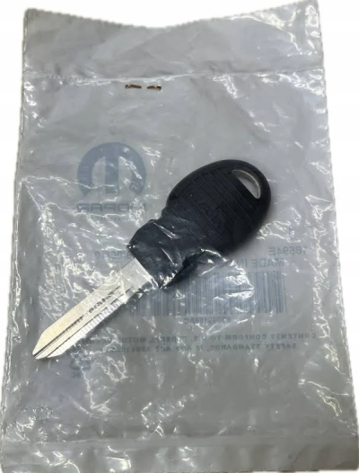

Hello i bought ram 21 classic with 2 keys (just with blade without buttons) i code key with buttons (keys are 1000% good and fits the car), and cant use it (open, close, panic doesnt work) just can put key to the ignition and start car. Is any1 know this can be bcm codeing ? no any antena ? or any other solution ?

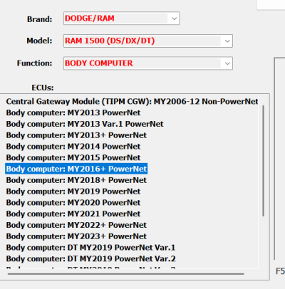

what option in afla obd should i looking for ?
Dodge/Ram>Ram 1500 (DS/DX/DT)>Body Computer
then
Car configuration change
Find RKE > VehConfig 3-RKE System Present>Yes
But, you need to have all the wiring and solenoids present. If your truck didn't come with the equipment, it may not even have the wiring harness connectors.

it works!! thank yoy very much ! :D
