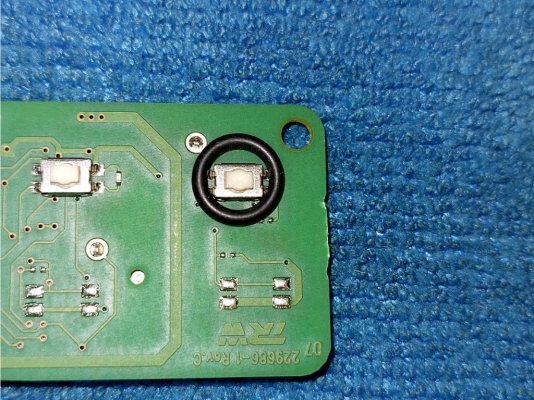

I'm confident there are many different key FOB types.
The link below is for the FOB used with my 2021 Ram Classic 1500 Warlock.
This FOB utilizes microswitches as opposed to shorting contacts together so you can't simply insulate the contacts like other types.
The video demonstrates how to disassemble the FOB for a battery change and I added a couple of pics to show how I've modified the panic switch to hopefully lessen the sensitivity.
By adding an O ring around the 'Panic switch', the sensitivity appears to be reduced, somewhat.
I won't know until another pants-wearing day arrives. That could be October or another work contract arrives. :cool:
