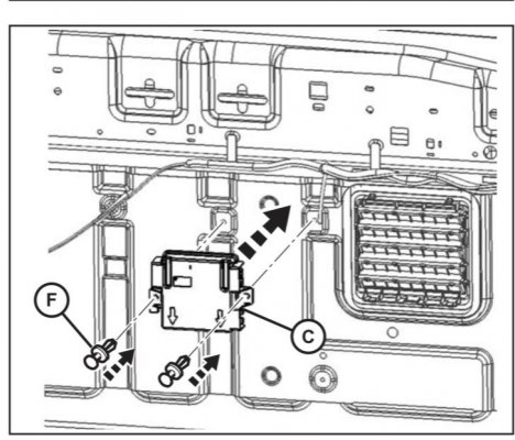

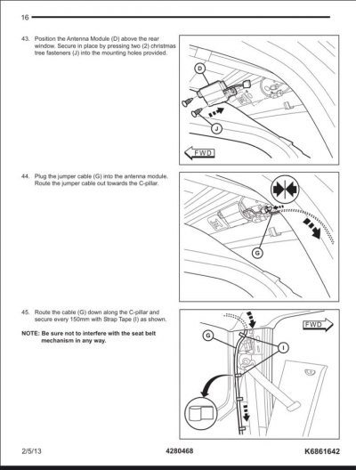

I have normally been able to lock and unlock my truck from my house, but today I noticed I had to be right up on the truck to lock or unlock it. I changed the batteries and cleaned all the contacts. Now I can get the lock and unlock to work from the house but I have to point it directly at the truck door. This happened with both Key Fobs at the same time, and it applies to the panic button as well.
Any direction would be greatly appreciated!
This implies it’s not the fobs...but the RF Hub and its antenna in the truck.
Here’s an excerpt from typical RAM fitting instructions for the RF HUB and Remote Antenna which shows you the location of the modules and cable routing:
