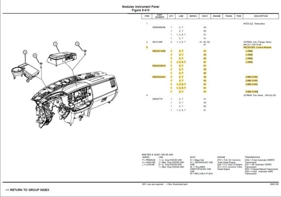

I don't have a 2009 specific manual, but 2009 HD's were the last 3rd gens so the 2008 HD parts book should be good enough.
As per the option code list:
XBM sales code = XBM $$ Remote Start System
GXM sales code = GXM $$ Remote Keyless Entry
ZG Remote Key Less Entry W/Immobilzer
ZJ Keyless Entry With Panic Alarm
