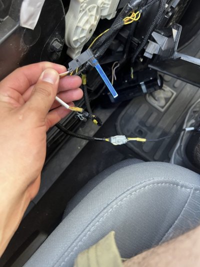

I manage to get my wiring from another truck that was from a limited and everything plugs in and works like a charm for me . No need to get a kit or anything for me . Just had to strip the wires and put it into mine and use alpha to add the code on it . 6AC66003-9A95-4729-9711-ADD87EF8D901.jpeg376F33FD-4A66-498C-8088-43622F11CFB7.jpeg866AA1F0-2DE1-4EC6-B6B6-493FDC9073C6.jpeg
Are you saying you pulled the OEM harnesses from a limited truck, reinstalled in your truck and programmed and everything workeD? This is what I was planning on doing, it's about 60 bucks per door harness and LB2 appears to be the sales code, at least for the rear. I was worried about it needing a pin on the body harness that might not be there.

I just checked my door harness and I'm missing pin 4 - footwell lamp and pin 6 - Passive entry in my body connector side. Does anyone know where to grab the footwell lighting or does the whole truck harness need to be replaced back to the BCM? I guess I can just use deerguy's wiring recommendation further back in this thread but I though maybe I was on to something being able to replace the door harness only.
