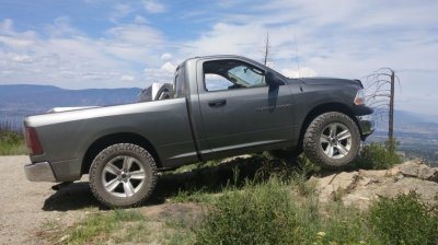

jled
Aug 28, 2015
29
13
AR
35 12.50 r18
fit perfectly
zeddy
zeddy
Dec 13, 2012
646
287
Burbank, Ca
fit perfectly
You have anymore pics? I want to keep my stock 18 wheels and am curious on how they'd look.
and confirming you do NOT have a leveling kit?

35 12.5 mickey thompsons on 2013 sport wheels on the half ton :)
