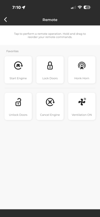

So out of curiosity I just recently received the update for my Uconnect 14 inch screen for Uconnect five in my route 1500 2025 sport 3.0L I–6 Hurricane.
So my main question would be I wanted to see the release notes for the update and it just said error receiving release notes and then went on its way.
Where can you find these release notes back when I had a Ford whenever there was an update, you could go to the website and you’ll be able to see what was in an update or it would just show up on the screen.
Why do they make it so hard to even find the release notes in the Uconnect system?
With this update, I did receive finally the ventilation option in my RAM app, and to be able to see my latest trips that I have taken.
And another question would be has anyone had issues updating their Tom Tom navigation.
I’ve been able to connect to Wi-Fi. I watched it complete the download but every time I turn the truck on and off it’s still probably me saying that there’s a navigation update.
So this is a two-part question, but I would really like to know if there’s any way to actually make this system function.
And has anybody received the update for your mobile phone to be used as a key?
Thank you in advance and can’t wait to learn a lot through these forms

Is that Apple app? I dont have ventilation ON option. But I have the 8.4 and still have the internet/wifi.
I'll have to look into this a little more.
Sorry I have no insight.
Yes the Ram app but you do require to be set up with ram plus plus service for the update
