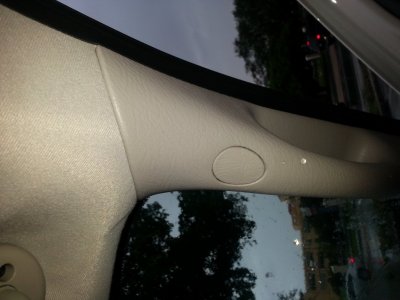

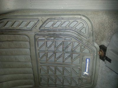

pictures water leak
the water from the handle (screw) goes out

Check the water drip rails. If the channels running down the door jams by the windshield and where the door latches to the truck are clogged then it would force the water else where. Very common problem in 07 to 2009 jeep liberties. Leaks in the same spot.

leak water
and I brought the car to a auto glass store the water doesn't go through the windshield
and seal the third brake light urethane and water problem continues
thanks for the help

Do you have cab clearance lights? A sunroof? If you have a sunroof there is a drain line that goes through the a-pillar that can leak. If you've sealed the wind shield and 3rd brake light then I would check the door seal. Pull it out and then silicone the holes when you re install it. There have also been a problems with leaking at the rear roof/side body panel seam, that would be harder to fix.
