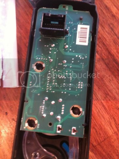

4x4 selector.... any ideas? if i take the blue covers off (they are rubber) the light will be yellow... maybe some 3mm plain blue leds prewired with 12v resistors? and solder them in there? think ill try this...
hvac with the back off...

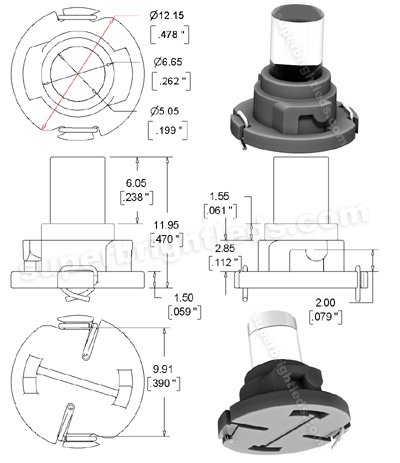

bulb on right is oem hvac, bulb on left is b85d. i ordered neo5's for this, should be in monday, look just like oem hvac hopefully they will work
these are the neo5's
back of cluster..... 11 b85d's just ordered more... anyone else have this many??
inside of headlight switch, with WLED soldered in with frosted tape over light for diffussion. hope it works.
also, when taking the back off of the 4x4 selector, theere is a hidden screw behind a sticker.... remove this before popping the plastic clips off... i broke mine... ( electronic 4x4 selector)
