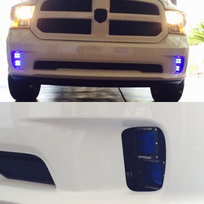

Do these Sidetracked Offroad LEDs have any blue to the light? Their website lists their color temp at 6000k...
I'm looking to install a set of these AND swap my low beams to HIDs, but I want to make sure the color is the same - are these LED fog light cubes the same color as 6000k HIDs or do they better match the 5000k HIDs (no blue present)?

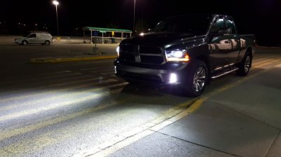

Well guys, I ended up pulling my LED fog cubes off. Went back to the stock housings for that OEM look but put in a 7200lm LED bulb kit (3600lm / bulb) and they are BRIGHT! Plug and play install. Way brighter and a more cleaner look IMO than the LED cubes were. It was 99$ for the kit. Just an option for yall if you want to keep the OEM look but have high quality, bright LEDs instead.

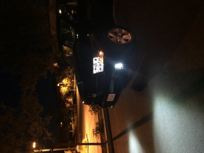

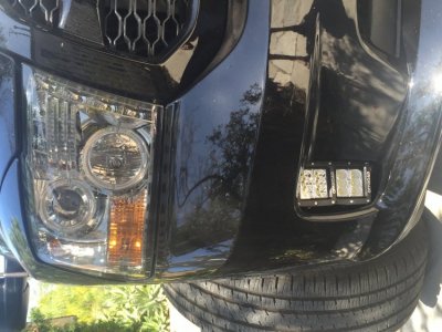

finally got around to installing mine, going to be nice when towing the boat thru some of the sketchy dark back roads by the river.

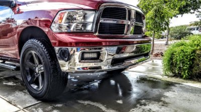

I have 4 Rigid Dually's in my factory fog location. It is a very tight fit and a major PITA to make any kind of adjustment. I may try single 7" bars instead.

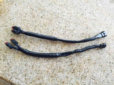

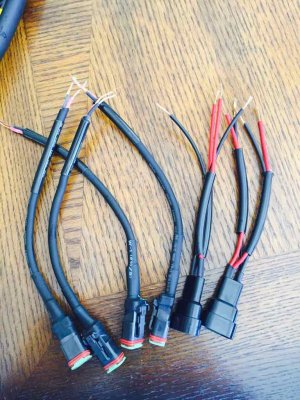

I've got a set of these brackets and the wiring pigtails from Alteredoffroad, PM me if anyone is interested.
I decided not to run them because they weren't plug and play on my 2015 and I didn't want to wire up a relay for them. Not sure if everyone has been having this issue with the 2015s or if some have worked.

I swapped out the 4 Duallys for 7" pods. Up close the gap is bigger than Michael Strahan's front teeth but not bad otherwise.

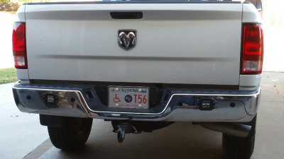

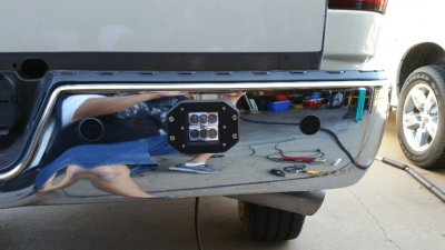

Well did this mod today, installed KAWELL 30 degree lights. First I made a template, then drew a line with grease pencil from the center of the 2 rear sensors, taped down template after centering, traced with Sharpie marker, then took a 4.5 cutting wheel and cut the 4 lines, cleaned up shavings with a dremell, applied rust prevention/ inhibitors to stop rust, place lights in hole and marked the mounting holes. Install light, bolted it down, install 2nd light and wired in. I used my #2 Aux switch, (hot all the time even without a key). Pics provided...
