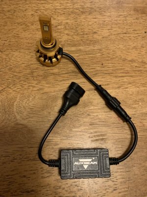

8CF16188-24FB-40E6-A1A7-82526BB736A1.jpeg Isn’t the box inline the Canbus driver? Or am I mistaken?
