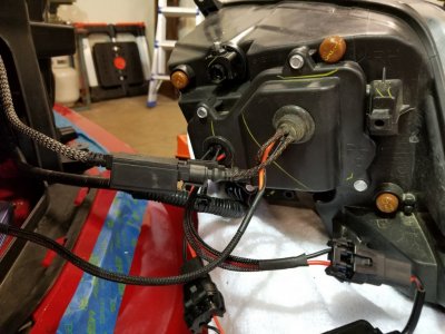

This is not correct. You will have to drill a 3/4 inch hole in the dust cover to install the water proof wire boot and wires to connect to the igniter and ballast. Here is one of my covers when I installed my HID kit.

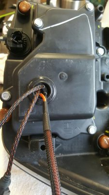

Just bc you do it and they give u the grommets doesn’t make it the correct way. How would you now run the stock headlight wire connector out to hook into a morimoto relay kit? I have 3 sets of wires sticking out the bottom of my cover, D2S to amp adapters for FXR HIDs, stock halogen headlight low beam pigtail (connects to morimoto relay harness), and highbeam splitter to activate solenoids on MH1 7.0 retrofitted fogs. How would u get all that out of your grommet?
Jeremy, the guy who literally does this for a living doesn’t drill holes in the cover like you. I personally think it looks like a hack. Why drill a massive hole in the back cover when you run it out the bottom and slap the cover over it? I did it this way but knotched our the headlight lip so it doesn’t pinch the wires when I tighten the cover. Almost impossible to get water up it either way and it still seals to an extend. 3 years and still going strong. Everyone has there own way, neither is correct.

Well, I am glad you are happy with your install. That is all that matters. But of you look at the photo of the back cover, two of the wires go to the Morimoto relay harness from the stock connector, and the other two wires go from the igniter to the HID bulb.
And when I installed the in the high beams I used another boot. This way I am not breaking the seal on the cover to let moisture in.

I don’t sorry. There is a raised lip on the headlight, the cover sits on that raised lip and a thin foam gasket pinched against it to seal. If you knotch out the raised lip you can fit the wires easily. As long as you cut the lip to only what’s needed the wire will slip into the cutout and the gasket will seal into the wiring. It’s not 100% waterproof unless you add some silicone which isn’t a big deal. But the water would have to come up 90 degrees (basically fight gravity) and wiggle it’s way through the wiring into the housing.

So you drilled two holes and used 2 grommets. Basically creating 2 leak points. I understand they seal well and you probably used silicone to sea them but I’m not a fan of modifying the headlights that much. You could never convert back to stock or you would have to find replacement covers. I don’t disagree with what you did, it’s a clean easy way of doing it, but it can’t be undone. My brother an I did the same thing on his 2015 Denali 1500 as yours and it worked fine, but it would be my last option.
