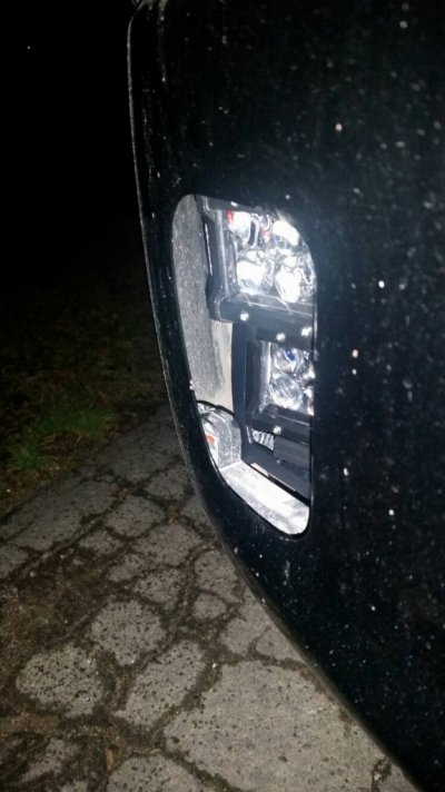

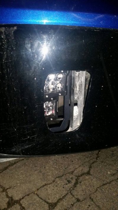

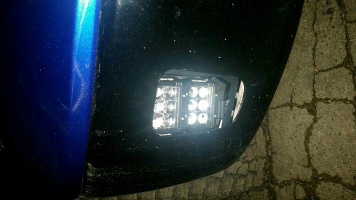

I just received my ICI brackets today and trying to mount. I am very disappointed at how they fit the lights. The lights are not aligned over each other and set way back. Can't even get true flood and also fit and finish now looks shifty. You can see right in and notice the plastic original brackets and such

These are not stamped they are plasma cut and the tabs are welded. They are ICI brackets made for 2013-2014 Ram vertical fogs so the correct ones. I also put the spot in the lower back position and flood on the upper and lots of lost pattern behind the bumper. I mounted just the passenger side and was just outside checking and that's what I came up with. I believe I'm going to reuse the outside mounting ring and cut off the stock tabs and weld on new ones. Just sucks to spend $50 on brackets that don't even come close to representing what they advertise.

I like the idea of these but them being so recessed would drive me crazy even if no one else would notice lol
Exactly why I'm feeling depressed right now. I will have to take out the cutting disk and welder to make them work
