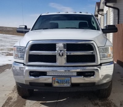

I bought some "L" brackets that attach using the two inboard tow hook bolts. Take the tow hooks off, then hold bracket in place and put tow hooks back in place. Brackets are only 1/16" thick but did come with slightly longer bolts to use.
I got all the parts, just haven't done the job yet. Where I live temporarily, I can't work on a vehicle. Oh, I also have this to remove first. The grille guard also uses all the hole for the tow hooks. I'm already running eight longer bolts (1/4" longer).

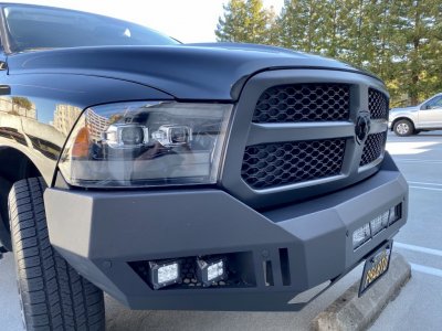

I made some home made brackets and installed a 30" straight bar in mine. Have to make sure it's a true 30" (or less) at the ends because most 30" bars are actually 32" and they won't fit. My 30" barely fits in there

If you don't have the ability to fab your own brackets, Rough Country makes a set for about $40 that I used. Works perfectly and looks awesome. I have the dual row black series with Amber DRL in my lower grill between the tow hooks

30" brackets? When I looked at them they were only for a 20" bar I believe? These should work for a 30"? When I mounted mine no one had brackets for a 30" so I had to make them.
https://www.dieselpowerproducts.com...ht-bar-bumper-mounts-03-18-ram-2500-3500.aspx
