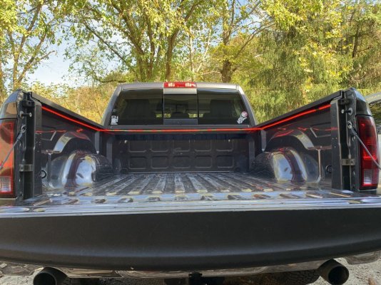

I ran my LED bed lights to the Aux Switches, I could have did it from the switch in the back since I had factory ones but I went with red so when I'm hunting the white light don't go all over the place so I put it on the Aux switch
