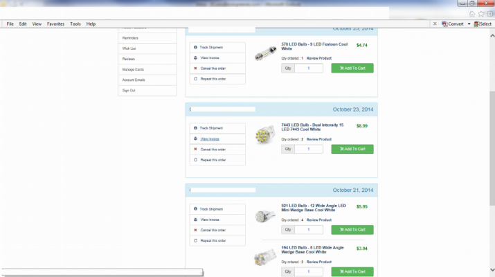

That's exactly the type of bulbs I used for reverse lights, third brake reverse light, license plate lights, dome light, and map lights. No errors. Bright and love them.
7443 LEDs are for the premium reverse lights (the sport tail lights)
194 are for the license plate lights
921 Map Lights and Third brake reverse light
578 is for the dome light
Also; when replacing the map lights, even if they're on for half a second they're damn hot and hard to remove. Either try a tool or do what I did... use both index fingers to remove them. What I did was instead of trying to grab and pull I'd just keep using initial force to remove them if that makes any damn sense haha
