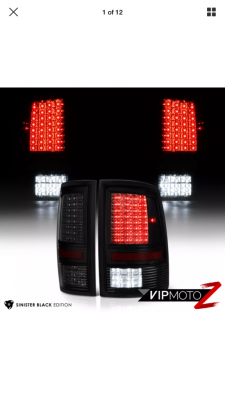

2010 Infantry Vet
Jan 8, 2018
3,550
1,935
Butler pennsylvania
2010
See? Why can't the other's do that as well?
No idea. This is the only brand that has multiple LED reverse lights built into the housing that I am aware of. Heck as far as I know, I am the only one running these tail lights. A lot easier to buy a tail light that already has reverse LEDs than add them. I paid $160 shipped
Wahrsuul
Nov 16, 2011
2,779
8,613
Central S.C.
I've seen one other that does it, but they're a lot more expensive.
