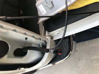

Good evening Peeps,
I want to add an LED under tailgate light bar on my ram however, don’t want to route the wire on the exposed side of the bumper (simply tacky in my opinion) therefore, I saw on Amazon a harness made by Curt (56584) and it seems to connect between the factory harness and drop a flat 5 connector (which I would use to plug the LED tailgate lightbar for a clean hidden install. Has anyone done this before? I would the Curt harness work as I would like? Thanks in advance for your anticipated help!

Works perfectly. I have another harness made by curt that provides the 4 pin flat connector instead of the 5 pin that you are showing.
BEHIND the back bumper you unplug the factory wire harness from the connector on the bumper. Then one end of the above harness gets plugged into the factory harness you just unplugged and the other end goes to the back of the plug mounted on the bumper. All of it stays BEHIND the bumper hidden and it still retains the use of the exterior mounted plug so if you needed it to hook a trailer up you still could.

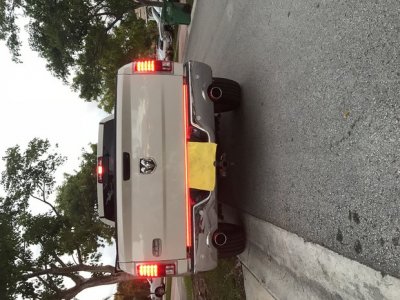

So got everything wired up extra clean and professional and love the outcome. See pics below!

Looks great.
Do you feel it would still stick even though my truck has Line-X in that location?
