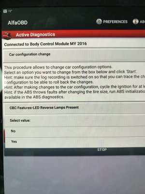

You can do it easily with alfaobd, I set mine and they work great with no more PWM

I have morimoto 35watt HIDs in mine and I love em. I just did away with the relay harness and resistors on mine by activating HIDs on my alfaobd. Now it's just ballasts and ignitors. Was able to get rid of the resistors on my morimoto fogs as well. Was running 55watt ballasts and had nothing but problems with those and the relay harness was the kit came with.

Simple, possibly idiotic question. Instead of buying alfaobd and doing it myself can I have the dealership update my fogs to LED after I install my BajaDesigns?
You can try. Some dealers won't do it at all. Some will charge you ($150 or more). And you'll have to pay every time you want to switch something. Having the dealer do it is a horrible option. Find a person ion your Santa Barbara area who can do this for you.

I was somewhat apprehensive about using AlfaOBD too, but it’s easy to use and there’s plenty of support here to walk you thru anything.

Sounds like a pretty cool thing but if you’re driving a 2018 and up, and are under warranty, you gotta buy that security bypass cable that’s behind the Uconnect screen, for it to be able to talk to your computer. And if you ever need warranty or recall work, you gotta hook the security module back up in order for the dealer’s computer to be able to talk to your truck. Seems like too much work to me.
The’19s don’t use the Security Bypass module behind the Uconnect screen. They use a bypass wiring harness that goes under the dashboard near where the OBDII module plugs into. Pretty easy to install. Even with the tazer ram plugged in, the OBDII port is still open for the dealership to plug their unit into. What I need to know is what they enter their PIN into so that I can change my tpms settings.
