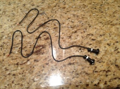

Got 6 of these lil guys off amazon for $8 bucks.

After installing these lights I would not recommend them only because the wire gauge was super small and a pain to work with. Other than that they worked great..really bright.
https://www.amazon.com/gp/product/B00FEZEVQK/ref=oh_aui_detailpage_o02_s00?ie=UTF8&psc=1
Just finished Backseats. Stupid picture is sideways.
Thanks for the link and looks good. Did the small wire break on you while installing, I'll be getting them tomorrow and put them in Saturday with my 52" light bar.

It broke quite a few times...lots of profanity during this process.
