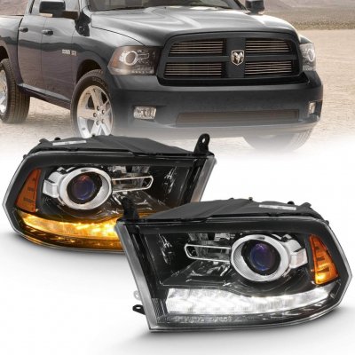

Sorry I can't help, but I did find the photoshop from amazon pretty amusing:
Good luck getting them figured out if you haven't already.
