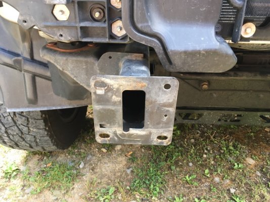

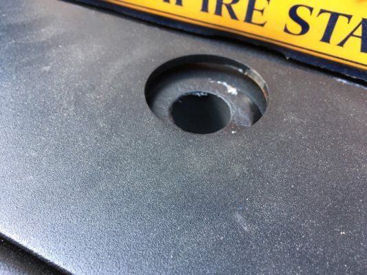

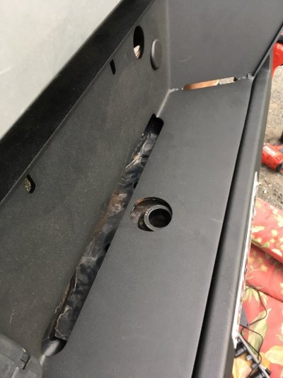

The grill? No. However, each bumper had its own set of challenges. For the rear bumper, the mounting brackets bolted up to the existing holes. I had to grind off the hitch boss because the bumper couldn't be fitted right otherwise.
The two most bothersome things about the installation were dealing with the parking sensors and installing the license plate with the new LED lights and license plate bolts, which are one and the same.
For the front, there are slight changes between models. The frame mounting area is slightly different.
Basically, the top right hole is a slotted hole rather than what we have and I believe the stationary one is to the bottom right or left or whatever. Also, where both mounting areas are indentical parallel images of each other, the late model trucks have mirror images of that hole pattern. Also note, I did have to do some drilling but nothing major.
