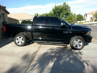

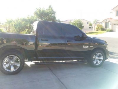

Kris319 Hi ! yo bro i have my lift today with that Maxtrac kit u and Rambo was helping me .I order it from realtruck web site and i also call the tech guy of Maxtrac and he also confirm i do not need a UCA with the kit dat i order ,will see how it look with the pic bro.
Awesome! I'm going to try and install mine tomorrow if not Monday. I look forward to your pics!

And more meat for the rim come on lol
